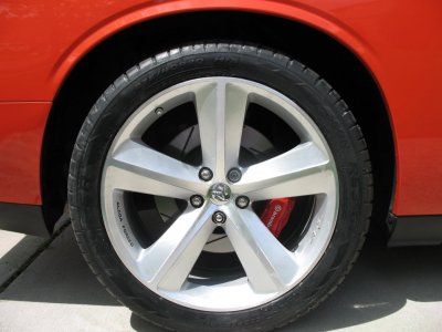

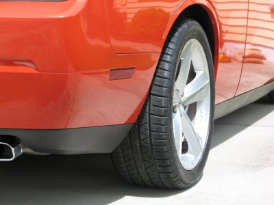

    First off, go with 275/40 tires all round, your car will handle way better and you'll have more traction. It's like a night & day difference. Best thing I ever did on my 2012 5.7 R/T. As far as brand, I've had recent luck with Coopers (was told it was bought out by Goodyear). I have their Zeon RS3-G1 on my 2020 widebody (315's) and they have better traction than the factory Pirellis the car came with, plus they come with a 50K mi warrantee and cost less. I found that Discount tire has the best prices & offer free rotations & balancing, which I take full advantage of every 5,000mi.

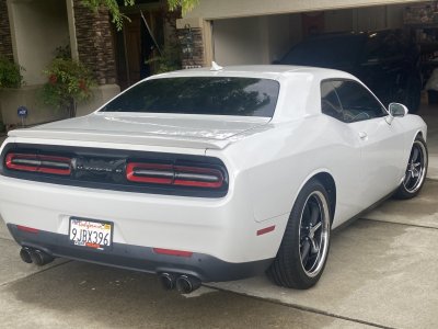

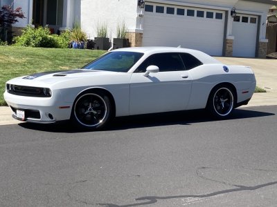

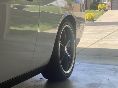

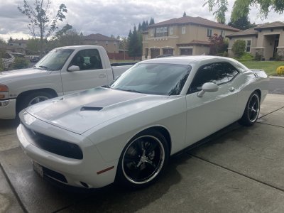

    IMG_0174.jpeg IMG_0167.jpeg IMG_0156.jpeg IMG_0163.jpeg Well their on and this is the result, I really hope you guys like....... IMG_0174.jpeg IMG_0167.jpeg IMG_0156.jpeg IMG_0163.jpeg IMG_0163.jpeg
