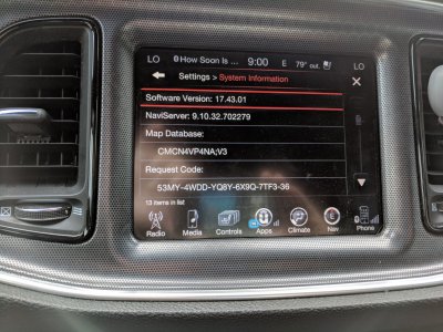

    @Wizard of Iz What is the revision of your PCM software? Is it newer than this?
  6. Wizard of Iz
    393
    Ill have to check to see if it changed. That’s the version I had before my trip to the dealer.

  8. Wizard of Iz
    393
    Confirmed. Still on software version 17.43.01.
    The update performed on Wednesday was supposedly specific to the HVAC system to correct a condition where the blend door would lose its full range of motion.
