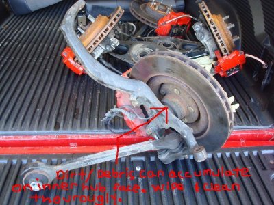

    While the cause of the lights was a bad sensor, this same type of problem can be caused by dirty wheel sensors. For those of you who would like to know how to clean them, here is a step-by-step guide:

    Once wheel(s) is removed, look up and over the rotor- follow the sensor cable to the inboard side of the steering knuckle. You should see a sensor held in place by a 10 mm bolt. By looking at it alone, you will notice that the sensor body, travels through a cavity in the steering knuckle, and reads movement as it "sees" the inboard side of the wheel hub bearing. This is a place where dirt and debris can easily get to. (see photos of an SRT spindle, below).

    Using a 10mm socket, remove the bolt and washer. Twist the base of the sensor gently back and forth to break it loose. Pull it straight out the back of the steering knuckle base. You will now see the sensor in all its glory (looks like a rectangular shaft). Use a damp cloth, and wipe the sensor clean ESPECIALLY the square tip, (eye) as this is how it gets its readings. Do not reinstall sensor yet.
    STEP 5
    Using a damp cloth (no chemicals), wipe the inboard side of the bearing- you can hold the cloth in place with your finger, and use your other hand to turn the rotor. Repeat this as necessary to ensure all dirt and debris, has been wiped away.
