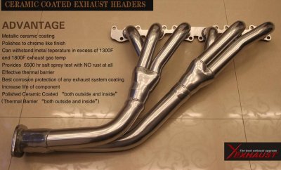

    Header wrap will degrade pipes. In a non-race application, it will take longer but it will eventually occur.
    The best solution, although an expensive one, is to have your headers ceramic coated.
    Engine Master Headers did an extensive dyno comparison test of coated and uncoated headers. Here's their results:
    "Coatings: Are They Worth It?
    As a part of our test, we wanted to quantify the benefits of a coated header versus a plain uncoated black painted header. A thermal barrier ceramic coating adds considerably to the price of any header, often doubling the price. We tested two otherwise identical Hooker 1⅞-inch headers with surprising results. Running on the dyno, we found the power numbers virtually unchanged.
    Where the ceramic coating made a remarkable difference is in the heat transferred by the header. We tested the header temperature immediately after a run, and then one minute after shutdown. The coated headers measured 258 degrees F dropping to 195 degrees F a minute after shutdown.
    In contrast, the uncoated header measured a scalding 870 degrees, retaining 520 degrees a minute after shutdown. We didn’t need a heat gun to tell the difference in the test cell."
    That is huge! If you can keep 500° out from under the hood, you are helping everything under the hood.
    Here is a photo of a coated header. Besides the previously stated benefits, it makes your engine bay a lot more attractive.
