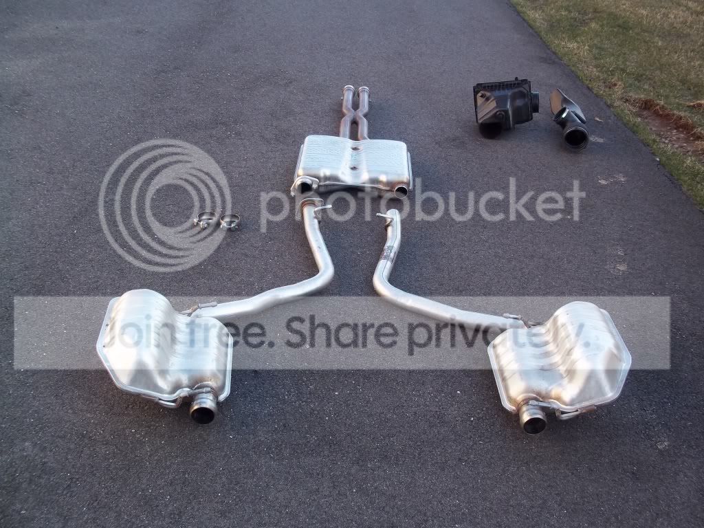

    Everybody makes the mistake of thinking the muffler is in front of the resonator on these exhaust systems. just in front of the end tips, that unit is your muffler and the resonator is upstream from that. it was the same with the '70 and later challengers. i don't know why the engineers did it but they did. if you replace the muffler with something else get a good tune. Sean at HEMI FEVER did a great job for me at a very reasonable price. I've heard of jay greene, he is expensive. get the diablo sport tuner from diablo sport first. GOOD LUCK!
  7. SRT-Tom
    7,061
    2,174
    On the older automatics, like my 2009 SRT, the large "suitcase" muffler was in front of the rear resonators.
  8. Katshot
    Thank Dodge for the confusion. At one point the "suitcase" was actually a combined muffler and resonator. For a time, the resonators were in front and the Miller's were out back, then in recent years they swapped position. Recently, I read that modern cars with modulated displacement don't actually have resonators. Instead the rear components are mufflers specifically tuned for the 4 cylinder pulses. At one point, I tried researching the issue but quickly gave up due to a lack of credible reference material. So, until we can find some credible answers I'm afraid we're left with internet "experts".
    IMO, this is a huge reason why Challenger owners face such an uphill battle when trying to modify their exhaust system.
