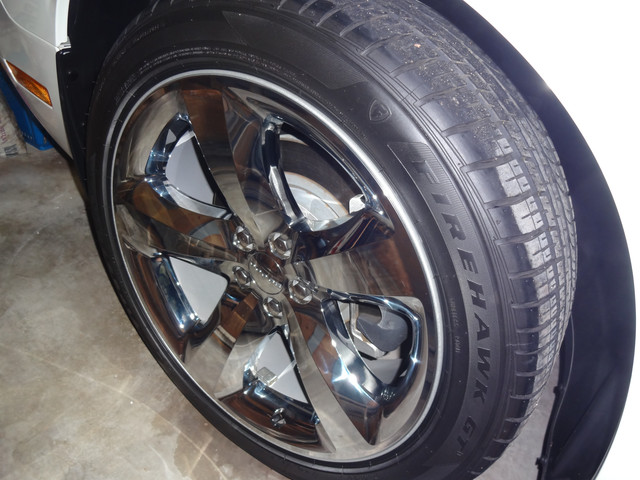

    I'd like to move to a wider tire without sacrificing the profile too much. Currently have 245 x 45 x 20 stock tires. I would like a little more contact patch. All replies are welcome.[​IMG]

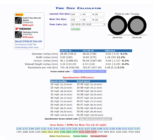

    * The sidewall height is slightly decreased with the 275 (-0.25) > -0.2%. On the 245, sidewall height is 4.34, as opposed to 4.33 on the 275. I believe the sidewall height is low enough with the 245, going lower to 4.33 concerns me. What do you think?
    However, you pick up 1.18 inches more (12.2%) with the 275 in width. This is a dilemma to me as which to choose. No real money issues to either size tire. The speedometer difference is trivial, as to benefit the 275 for slightly lower calibration. You're turning more Revolutions per mile with the 275 (0.1%). Every little detail counts.

    I doubt you'll see any difference with speedometer reading between these tire sizes due to height. I don't have time to research it right now but I'd bet there is more than a 0.02 inch difference in overall height just between different tire manufacturers for the same size tire.
    Also, the tread wear on a tire will reduce the height of the tire by more than this 0.02" difference. A tire that is worn down by just 1/32" comes out to 0.032".
    Mathmatically, the speedo calibration is changing more just because your tires are wearing down, but as mentioned before the difference is trivial.
