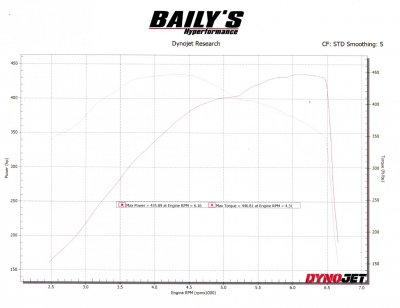

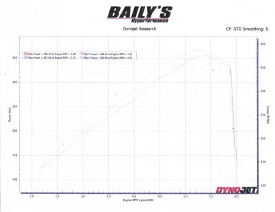

    Nice article. I added 1 7/8" Stainless Works long tubes to my 17 345 T/A along with a dyno and hooked them up to my 2 3/4" stock Active Exhaust. The performance difference was night and day. The car is also much louder (especially when I step on it) and it doesn't have that raspy high pitch you get from muffler/resonator deletes. Then I installed a Stage 2 cam along with non MDS lifters and pushrods because I have the 8 speed auto and H A T E MDS. The total house power and toque was amazing. I can't wait to race a Scat Pack.
    The first dyno is long tubes only. The second is dyno long tubes and the stage 2 cam. All readings are at the rear wheel.

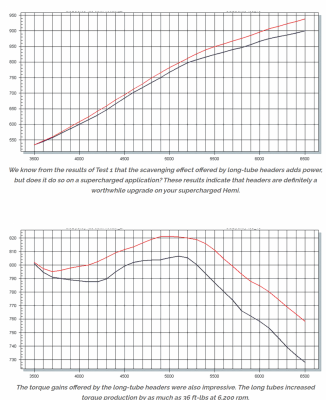

    To further destroy the idea that consensus equates to anything that may be related to reality, facts, or even sanity, I quote from this article:
    https://www.mopardiy.com/gen-iii-hemi-headers-shootout-finding-the-perfect-header-for-your-hemi/

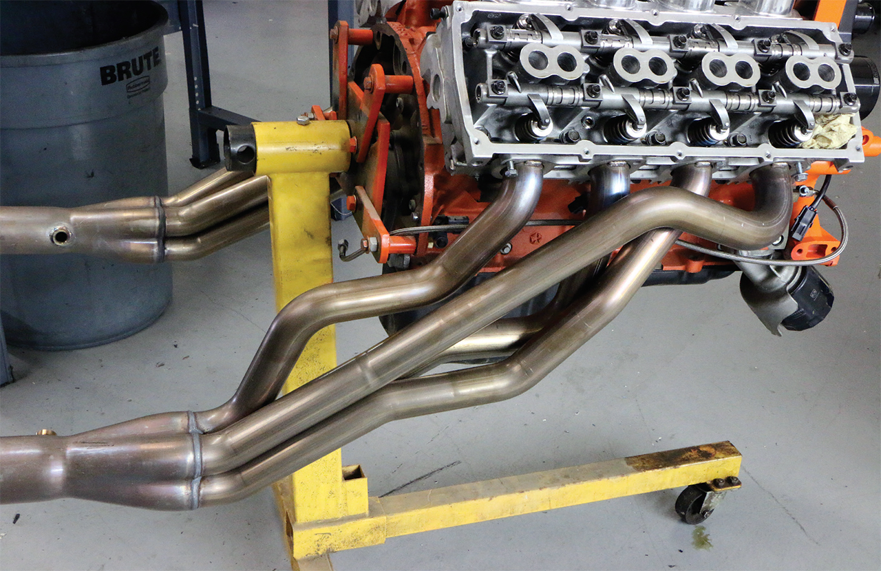

    "The scavenging effect offered by these headers from American Racing Headers was worth nearly 20 hp"
    Equal-length long-tube headers are superior to short-tube and unequal-length headers. This has been proven for decades by actual facts.
    Long-tube headers become even more beneficial when they are combined with more modifications that take advantage of their design superiority. These modifications can include a cam, valves, and a PCM/tune.
    Long-tubes scavenge exhaust so effectively, they flow MORE air for supercharged engines with less backpressure, leading to a reduced intake manifold air pressure reading while simultaneously flowing MORE air.

    Even from the article you've sighted Moparisto, which describes beneficial exhaust mods to a mildly modified 5.7 "Shorty headers are very popular; they are easy to install and often emissions legal. The problem or limitation of shorty headers is that while they make flow better than a set of stock exhaust manifolds, especially the cast-iron Hemi truck units, they do not offer the necessary primary tubing length to produce the desired scavenging effect. This test illustrates that on a mild 5.7L Hemi application, the shorty headers offered nearly as much peak power, but note the gains offered by the long-tube headers through the remainder of the curve. Run with the shorty headers, the IR injected Hemi produced 461 hp and 413 ft-lbs of torque. After installation of the headers, the peak numbers changed to 462 hp and 418 ft-lbs of torque." Low end power loss on a stock or mildly modified (cammed) street car is going in the wrong direction for a long tube hp gain of 1 somewhere in the power band and a torque increase of 5 ft-lbs.
