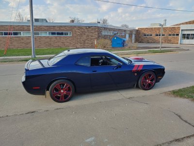

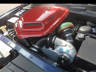

    Has taken almost 9 years to get her this far.

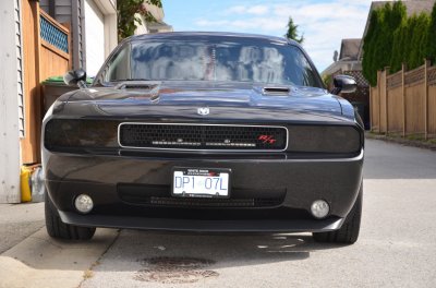

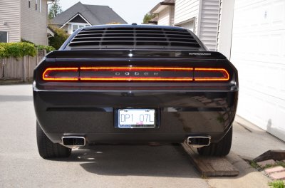

    Fortunately for me the original owner of mine took the financial hit on the mods. Obviously a labor of love for you with the extensive performance mods. Being capable of using E85 is a tremendous advantage for cheap octane increase (use a 30% mix on my 335's). Not sure why so many of our drivers taillight section sinks out of alignment on our model years? Thanks for sharing as it's good to know where we can go with performance on these vehicles.
