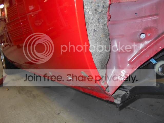

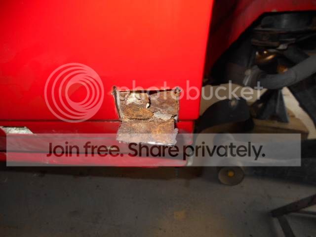

    That's the infamous rocker panel problem. It has been around for years and is most prevalent in daily driver cars located in states with severe winters. Apparently water is getting inside the rear fender in front of the wheel well. There is foam insulation inside this area, behind the plastic rocker panel. The foam is getting wet and it's acting like a sponge causing a rust issue.
    Here are some photos of it.
