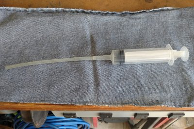

    Story: I bought this thing years ago, tried it a couple of times, and never had much luck with it. Then a couple years ago, a front caliper stuck on my '09 Sierra, and I just replaced them both (no-brainer), but bleeding the system proved to be a challenge. Now, I've always used the assistant method - little brother/girlfriend/wife/son pushing on the pedal while I open the bleeder. (See how the assistant changes throughout your life?) Well, we tried multiple times to get that truck's brakes right and the pedal just wouldn't stop being spongy. Enter the Mityvac! Hooked that thing up, squeezed and squeezed until the fluid ran clear, did the other side, and holy shit it worked! Truck is still good to this day - knock on wood! Guess it was worth buying. The other thing that I find handy is a plastic syringe like this one:

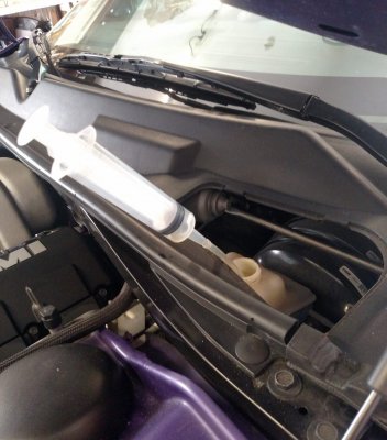

    Helps to have that long piece of plastic tube on the end, too. With this, I sucked all the old fluid out of the reservoir on the master cylinder, cuz you don't want to have to suck all of that through the brake system. It's just faster to empty the reservoir, then fill that up with new fluid before you start with the vacuum gizmo. Here's a shot of what that looks like:

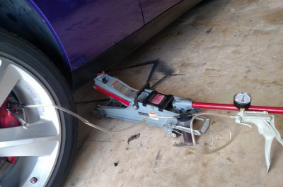

    DON'T FORGET TO REFILL THAT RESERVOIR! Last thing you ever want to do while doing this is to suck air into the master cylinder. If that happens, you are starting over from square one. So while you're doing this, check the reservoir often and keep it topped off! After all that, you're ready to start sucking the fluid through. Start with the wheel farthest away from the master cylinder, and end with the one closest. So, right rear. Here's a shot of the Mityvac hooked up to the caliper bleed valve:

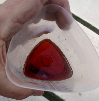

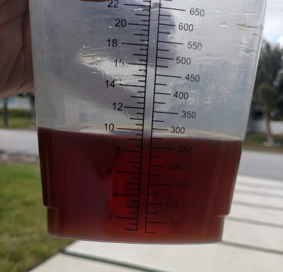

    I fully intended to jack up the car and remove the wheel to get to the caliper. But with these wheels, ya didn't have to! How nice. With the wheel in a good position, I could easily reach the bleed valve with a wrench and get the rubber fitting over it. From there, all you need to do is pump the vacuum and wait. I recommend opening the bleed valve only about a quarter to a half of a turn. Just enough to get the fluid running and no more. I'm afraid opening it too far might let unwanted air into the caliper. It probably won't, but you don't need to, half a turn is plenty to get the fluid to run, and that's the goal. From there, it's just a forearm workout. Keep pumping until the little jar is full, then go check the master cylinder and top it off. The gauge on the pump goes from 0 to full vacuum, I keep it about half way or about 15 inches of vacuum. Keep going until the fluid starts to run clear. Tighten the bleeder valve, dump the remaining used fluid, top off the master, and switch to the left rear wheel. Pump. Fill. Repeat. Here's what my fluid looked like, from a 2010. I bought it used in 2014, but I'll bet the previous owner never changed the juice, so, yeah, 13 years old. Truthfully, I didn't think it looked all that bad. I've seen a lot worse.

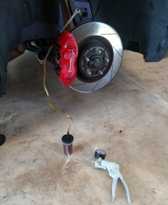

    Finish up with the front brakes. Turns out the bleeder valve on the front calipers is on the back side of the caliper. For these, I had to remove the wheel. But, no biggie, and it gives you plenty of room to work. Shorter run for the fronts, so a little less pumping. Don't forget - keep checking and refilling the master! Here's a shot of that set-up:
