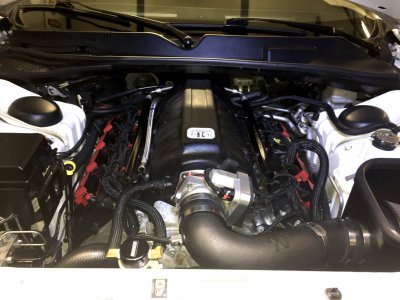

    Does it catch much? Who's supercharger are you using?

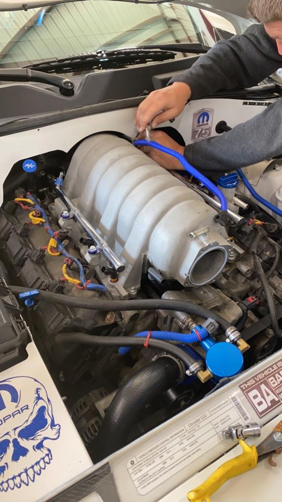

    I empty it around every oil change just depends on how much it gets driven( I only put about 5000 miles a year on mine.), and no supercharger, naturally aspirated. using a 6.1 intake on my 5.7

    Most mount them to a stud on the front of the block. The can will come with a bracket. This was my 2010 RT. I emptied every oil change.

    Of interest to some perhaps, the Magnuson supercharger kit includes an oil separator which routes the oil blow by to the new oil filler neck included, eliminating the need to drain a catch can which I think is quite innovative.
