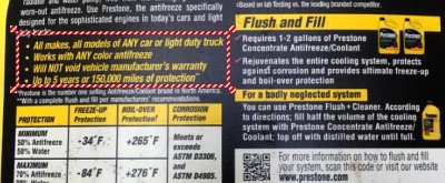

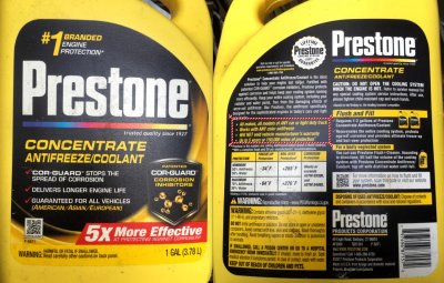

    Thanks for the information, but . . . . .
    7,090
    2,221
    Although it will work, I assume that it has to be changed every 2-3 years?
    I did a little research and found that Prestone replaced silicates with phosphates, so it should be save to use with all engines. However, I still prefer the Mopar HOAT coolant that was specifically formulated for my engine, instead of an "all purpose" one.

    This coolant topic has always confused me. I understand that car manufacturers recommend (or require) a certain coolant, be it HOAT or IAT. But then I go to the store and see coolant manufactures state their products are compatible with all makes and models.
    Is there a standard for the COLOR of the coolant? I've seen green, yellow, orange and red. Right now I only have a gallon of the green stuff for my 69 Camaro. I wanted to grab a gallon to top off my other cars if/when needed but I'm not going to have three other different gallons sitting around.
