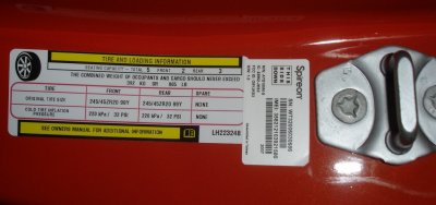

  4. NC20RT
    Look for this on the driver's door side. I just took this photo for you. It's on my 2020 R/T but I'm sure it's the same general location for other years/models. I think you can click on the photo to enlarge.

    OK, door info now has me even more unsure of whats right. Said org are 215/65R17 30 PSI, 4905 front 2810 rear 2810 CAWR 1275kg-no idea wgat that is. Current tires are all the same. Going from 17's to 22's just seems quite a change. Is there a formula for finding PSI'S?
