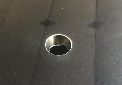

    Well One more project done finally.

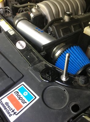

    Didn't like the Adaptor Plates that Mother Mopar used, so I made my own 1/2" Stainless Pins
    and put them in the Radiator cross brace where they belong.
    Pain in the ass, but worth the extra time.

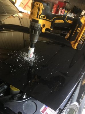

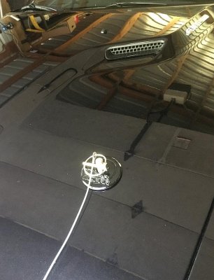

    As I made my own pins, I made one longer to use as a punch and sharpened it to "MARK" the hood for drilling.

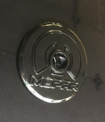

    Done :)

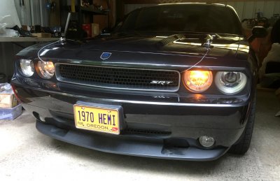

    Crap, my 10 year LED Amber Driving lights burned out again!
    This set is only 2 months old
