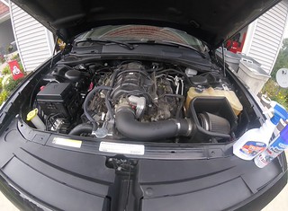

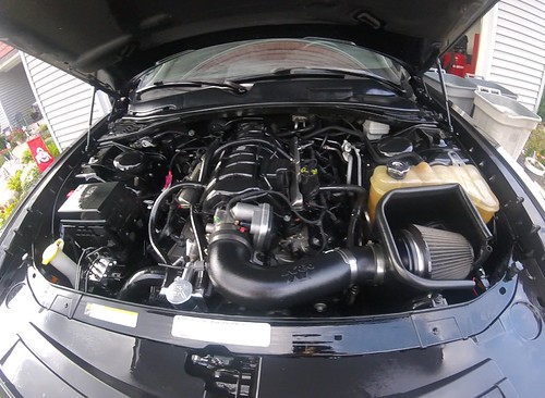

    GUNK Multi-Surface Degreaser for the dust/grime and GUNK Finishing Shine to finish up the beauty.
    [​IMG]< Yes, this is dry!
    How I do it with this brand (also how it states on the can):
    Apply Degreaser thoroughly all over the engine bay (yes even the wires, coil packs, etc.. I did however cover my CAI filter- my personal preference) leaving sit for 10 mins
    Once time has passed, set garden hose on a wide spraying setting, but only gently press the trigger. You just want it to wash off the degreaser fully and get the crud off but not overly-saturate everything
    *Optional*- Take blower and blow off some of the water on the electrical parts just to be safe!
    Finally, start up the engine and let run for 10-15mins to dry the rest of the water, apply your Finishing Shine and you'll have a great looking engine in no time!
    Total time taken (without having to cool engine down after driving to get the spray)- approx. 45 mins or so if needing to scrub some spots. The pair only costs about $13 and I could probably get 6+ uses from them.
    chithead and tct577 like this.

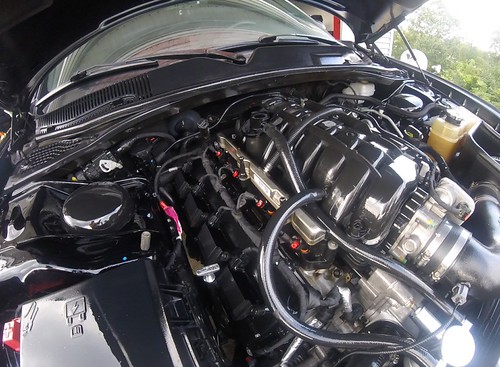

  8. rtchallenger12
    58
    Feb 3, 2017
    Columbus, OH
    Thanks, not really a fan with how messy it looks (wires and such) without the engine cover on the 5.7, but I like seeing my motor!
    I'm by no means the best detailer, especially for engine bays, but I was pretty proud of the way it turned out even without all of the dress-up most people do to theirs. :gr_grin:
