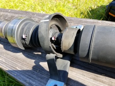

    If you are running the OEM 2 piece driveshaft parking on an incline puts a lot of pressure on the center support bearing rubber support gasket and can lead to its early demise.
    And demise looks like this.
    Once the rubber tears loose you have to replace the entire driveshaft, and it usually starts with a thunk sound, so keep an eye on it. Ry
