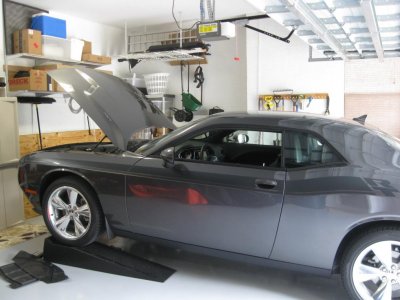

    Well, I did the first oil change on the 2015 R/T today -- 975 miles. Got rid of the factory fill and went to the best oil I could find (Penzoil Ultra Platinum 5W-20) and a Royal Purple 20-820 filter.
    With my RR-56 Race Ramps, it was an easy job, even for my tired 67 year old butt. Maybe its my imagination but it seems to run smoother and quieter already!!
