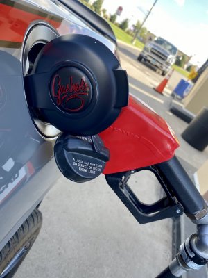

    Some of the black sticker has come off the fuel filler door and I want to remove the rest. I have used a blow dryer and a plastic scrapper with no results.
    I am afraid a razor will scratch the chrome.
    I am also concerned a heat gun will get the door too hot.
    Has anyone removed the black sticker?
    If so, what method was used?

    I don't know if it needs special care.
    The coating peeled off to and what remains doesn't want to come off.
    I like the looks of all chrome.
    I just need to know how to get the remaining coating off.
    I am afraid a heat gun will be too hot.
    I have tried acetone based fingernail polish remover and got no results.
