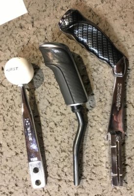

    Does anyone know if the oem pistol grip off a 2014 srt challenger m6 will bolt up to a 2016 Challenger
    scatpack m6? Do not really like the ball and still want it to look factory.

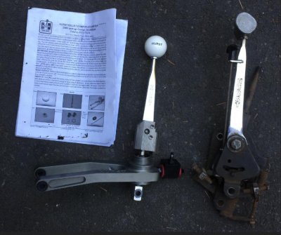

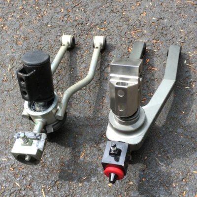

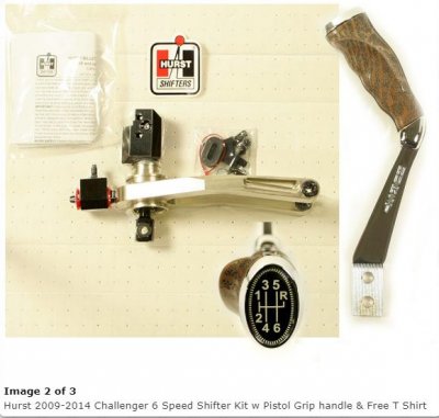

    So, the REAL Pistol Grip (Hurst) requires the HURST Shifter
    The 2010 ( and I am pretty sure, the 2014's were a rod that fit into a SLOT in the back of the factory shifter.
    The Hurst Pistol Grip (and the '70's) bolted to the SIDE.
    As did the Hurst BALL.
    Guess what I am saying is pull the console and look :)
    I'll have to look for the Factory Shifter pic's
    This is the 2010:
    And DON'T forget the CABLE :)
    You notice THIS Hurst shifter supports BOTH the Factory and the side flat style.
    And the shorter throw of the Hurst is worth it.
