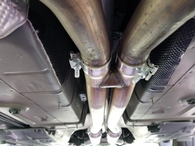

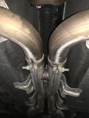

  7. 70-426_10-SRT
    The FACTORY X-Pipe acts as a good DriveLine Loop
    and more efficient than an old school H-Pipe
    Ha, just found the pic and we have BOTH :)
    Obviously won't pass Track Inspection, but better than nothing
  8. Katshot
    Never seen a X and H pipe on the same car. I know Corsa offers a double helix X pipe (not sure why) but have no clue whether multiple cross-overs are a benefit or not.

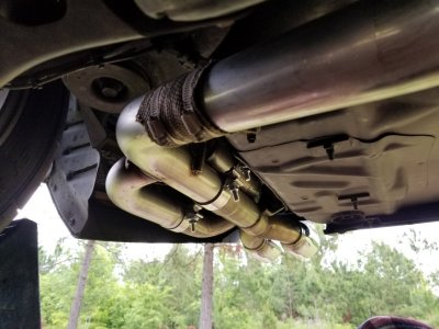

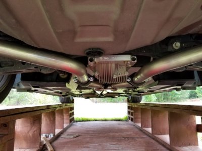

    Try SOLO Performance, they built this for me.
    This is their MR212-HJ Charger cat back that they remounted exhaust hangers for my 2015 Challenger, because in 2015 the exhaust mounts changed on the Challenger and they are the same from 2015 till today.

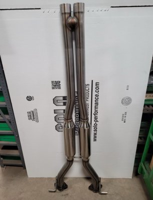

    Picture below is their J Pipe drone Canceling which works very well, quiet in town idling and cruising, until you put your foot in it!
    The H Pipe crossover sounds like American Muscle and also increases the bottom end performance. :) Ry
    Edit: I started with Flowmaster American Thunder, the drone was horrible, so bad it rattled my dash at about 1,800rpm, then Changed to Magnaflow with the X Pipe crossover, sounded OK but hurt performance. Now I am running SOLO Performance, and have zero drone, but they don't have performance in their name for nothing, but you'll have to find that out for yourself.
