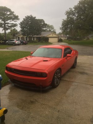

    Pictures as requested. IMG_0950.JPG 65827115887__68FB0854-BF32-4F1C-B173-5C1893B355F7.JPG

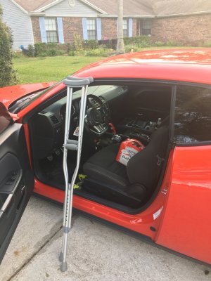

    Also to fill you in on the second pic;
    I ordered the Barton short throw shifter and broke my leg 2 days before it arrived. I got so bored just sitting around the house and was anxious to put the shifter in so it may have taken me a bit longer than it should have but it helped keep me sane while I was broke. So anybody wondering how hard that install is, I did it with a broke leg with no problems. The bad thing was I couldn't test drive it for 3 months though so all I could do was admire it.
