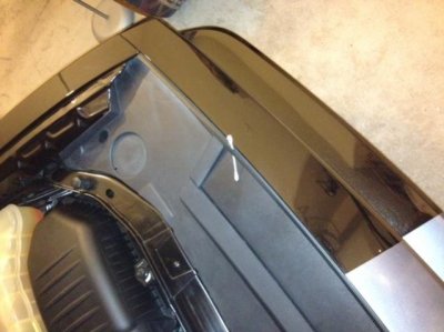

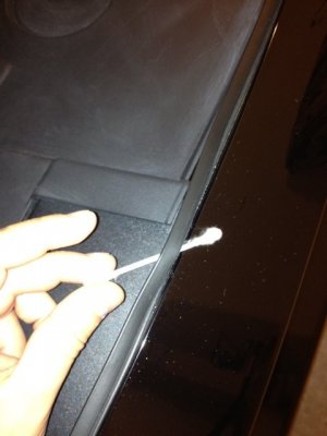

    Hello,
    I need a little help. the Rubber Seal that goes between the front of my hood and the front end is torn. Is this part easy to replace? Any suggestions
    Thx!

    If the car is still under warranty I would have the dealership replace it for you.
  3. Bullishman13
    101
    Sep 20, 2011
    NC
    Mine is a 2008, they still replaced it at no cost to me. I found a good dealer/service department.
    2,221
    If you need to replace it and you are out of warranty, do it yourself. The seal costs $30 and you can get the 11 plastic rivets that hold it in place, from Harbor Freight, for only a few dollars for a box of 20.
    Don't buy them from the dealer. You will be charged $63 ($5.75 each)!

    Neat alternative fix: Bought stainless steel screws at the hardware store (14 : 3/4). Fit perfectly and for only $1.09 for 2 screws x 6 bags. They look great and screw into the holes perfectly. Can use over and over again. Can paint black too if you want. A great looking alternative; I am very happy with how it turned out.

    Google Challenger hood seal. The results may direct you to a website or forum that you can get a part# from. I purchased mine online + a spare(recommended, it will fail again). It was a while back and don't recall the vendor but it was a Mopar vendor. Good luck.

    Another great option is to use a garage door weather seal. It works great and will last forever.
  10. SRT-Tom
    2,221
    Here is a DIY video.
    (Note- Instead of a screwdriver, you can use a metal trim removal tool or drill out the center of each plastic rivit. Also, a Poly Riviter gun and rivits can be purchased from Harbor Freight for $16.99).
