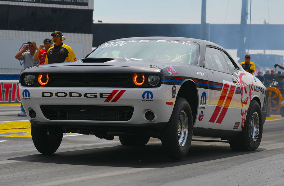

    Scoops would work best if place in clean air or at the grille opening (famed high-pressure area) and if they were large enough to flow maximum air unrestricted at low speeds. The closest I've seen in a Challenger is the Drag Pak.
    The Demon scoop, shaker, and the SXT's scoops are not optimally positioned to take advantage of pressurization due to facing clean airflow, and allow the air to ramp over the scoop.
    No race cars use scoops that look like the ones that get used on factory street cars.
    But even the race cars from the factory looked better.

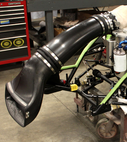

    Iterations of the Drag Pak: scoop mainly for blower cooling:
    A bit of boundary layer bleed:
    The new reigning dominator of the racing series in which the Drag Pak competes:

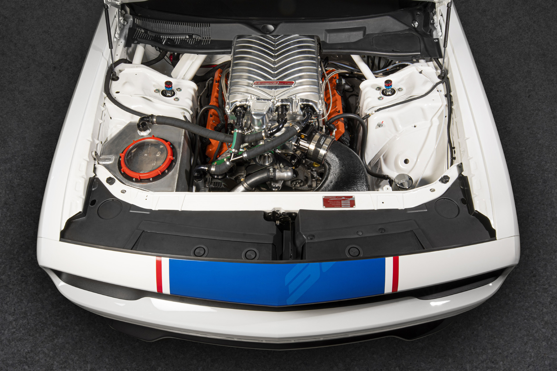

    You cannot see it, but the top several inches of the grille are entirely take up by the radiator-width scoop that funnels air into the engine. The radiator is kind of short in the race car.
    The top of the grille is NOT occupied by the radiator, but by the intake scoop.
    Rear view of radiator and scoop area:[​IMG]

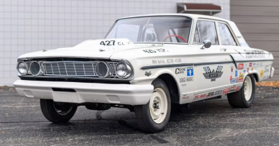

    The one pictured above on the Drag Pak near the grille is the best factory-offered air intake I've seen since the Ford Thunderbolt.
    See this pressurized beauty:
    Where is it fed?
    Right at the grille. Those two inner light bezels are sealed to the air intake hoses.
