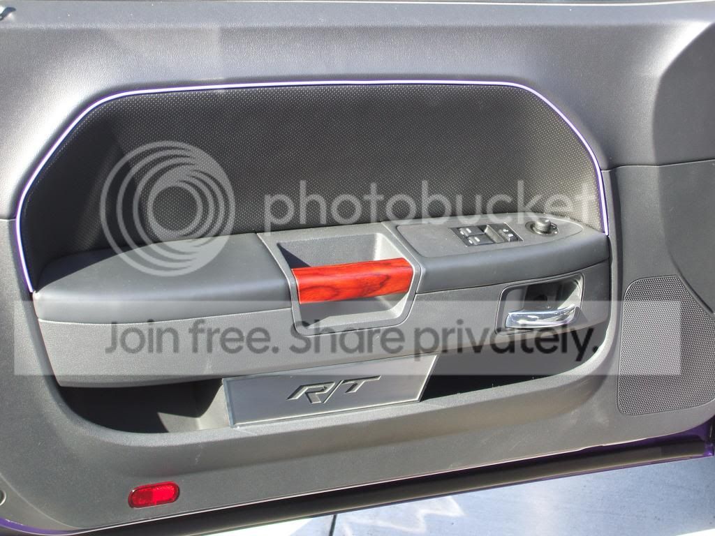

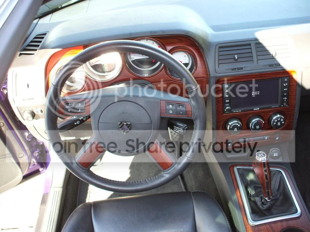

    I have 2013 Jazz Blue Peal RT 5.7L. black leather int. I put in a real-wood Japanese cherry wood trim kit, with the speedometer & overhead console kits as well. It looks great!! lots of trim kit choices on CAR ID . com
    the pieces on most are permanent adhesive, so you really want to be sure on your choice & careful putting it in, but, the kits by Remin are first class.

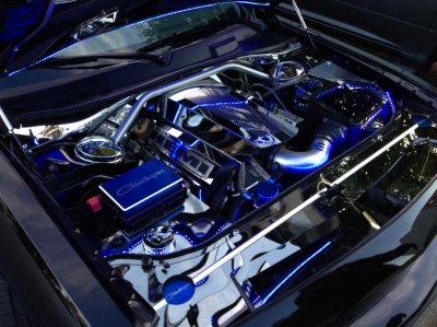

    Came down with the flu right after I sent that post...just got done with the dissasembly as you instructed. Perfect--no issues! I unwelded the instrument cups like you did and it went fine. Going off for shipping on Tuesday, will send end result pics when it's done. THANKS MUCH for the tips Jonman! Truly appreciated! Here's a pic of our engine bay. Bout time we did the interior...

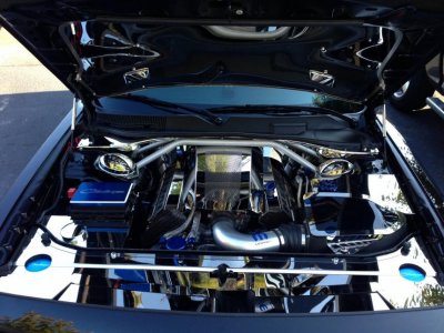

    Lit up....
