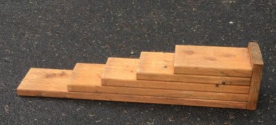

    I like those lift pads, but to do it right you do need TWO Floor Jacks
    I use the Wood ones I built for my Stealth years ago.
    The trick to building them is to drive the front tire up on the 2x8 or 2x10,
    then and the second board and so on.
    then just screw it together.
    Worked GREAT for the Exhaust, and oil changes.
    These get you 7 1/2" off the ground.
    I was planning on adding another to get to 9", but these are heavy enough as there are :)

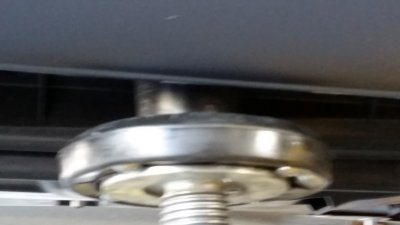

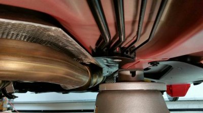

    Ramps are good as long as you don't need to remove your wheels. The Challenger has lift points on the chassis (other than the pinch welds) that an be accessed with lift adapters on a 2 post lift. If you don't have a lift, a similar type of adapter exist with Jackpoint Jackstands. The second picture shows the Jackpoint adapter on a Charger but the chassis lift points are similar.
