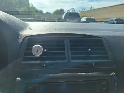

    Not sure if this is the right place to post this, but looking for recommendation on how best to repair my dash where it surrounds the AC vent. This is in my 2014 SRT with 55K miles on it. When I try to push it back under the vent it just pops back out. I appreciate your consideration. 20240823_161622.jpg

    Thanks Tom, just what I was looking for!

    I just did that for the right hand vent. I used a similar clamp as pictured. Definitely use something like a paint mixing stick to distribute the clamping force. I did not, and it left a dent. Eventually the dent in the dash came out on it's own, but I was not sure it would.
