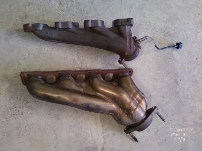

    Those SRT exhaust manifolds are a great upgrade for sure! I think you will also need the midpipes with those too because of the pipe size difference between SRT and RT - can anyone confirm?

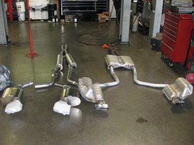

    Here's a couple pics, one is a comparison of the stock exhaust vs the Corsa catbacks (the stock stuff is BIG, on the right) the second is a comparison of the SRT (gold colored) vs stock RT exhaust manis. Yes, the stock SRT mids will work. Also, the SRT headers bolt right on to the 5.7 engine.
