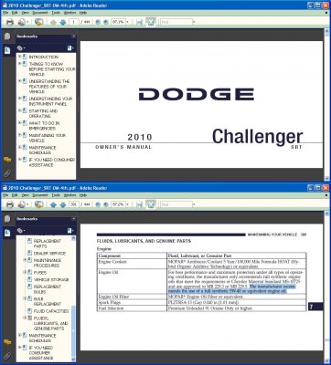

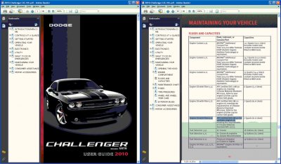

    That clears up a minor bit of confusion for me. I have the 6.1 liter Hemi. The cap on the oil filler says fill with 0W-40. The owner’s manual and user guide say to use 5W-40. Various helpful souls on this forum have suggested one or the other, but which is best? According to that video, it sounds like it really doesn’t matter, since I live in south Florida, where the temperature never goes below 40 degrees F. Remember, the factory recommendation has to apply wherever these cars are sold, so maybe using 0W versus 5W makes a difference in Anchorage Alaska, but I doubt an engine that spends its life here would care. I could probably go with 10W-40 as well. Thoughts?
    7,083
    2,214
    My 2009 Owner's Manual states the following: "Engine Oil Viscosity (SAE Grade) SAE 0W-40 engine oil is preferred for use in 6.1L engines within the operating temperatures shown in the engine oil viscosity chart. SAE 5W-40 engine oil is also allowed for use in 6.1L engines".

    Here's a page out of the Owner's Manual:
    This one's from the User's Guide:
    Apparently, Dodge changed their recommendation in the 2010 model year. The problem I have is that 5W-40 is hard to find. Well, at Walmart anyway, where I go to get oil cuz they have pretty much the best price around. And when I do find it there, it's the "European Diesel Blend" or something like that, so I'm not sure that's the stuff I should be using. But the 0W-40 is always available, and for a good price, so I've been going with that. I reckon the 10W-40 wouldn't hurt, being in South Florida where it's always hot, and that's easy to find too. As long as I stick with the "40" number on the high side it should be ok.
    At the end of the day, changing your oil and filter regularly is probably way more important than the difference between 0W or 5W or even 10W, but it's nice to know you're using the best oil for the car.
