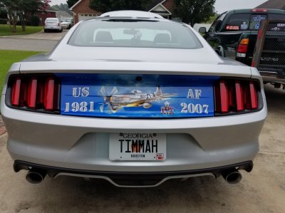

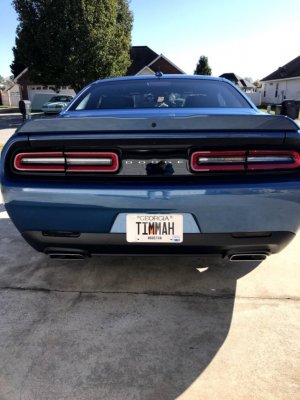

    I've been trying to find a plain trunk lid panel (between the tail lights) that doesn't have the raised Dodge letters on it. I have a 2020 so I don't know if earlier versions had a plain panel or not but in my search of pictures nothing comes up. I would like to use that area for a design like I did with my Mustang Show.jpg trunklid.jpg but those damn letters are molded in. I've seen smoke covers but I'm not 12 with a JC Whitney catalog and don't want to smoke out my tail lights for obvious safety reasons and it just puts a cover over that area anyway. Has anyone found a way to make that area useable?

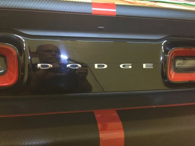

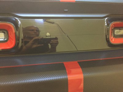

    Are you sure that they are molded as part of the panel. On my 2020 SXT it seems like they are stick on.
  3. 2017 Redline HC
    Bacon Sandwich likes this.
  4. B5blueRT
    They're removable on a 2015 too. Warm them up with a hair dryer or heat gun and them use a length of dental floss to get behind each letter to work them off.

    Thanks, they looked molded on I guess because of the black. Now for my next mod....

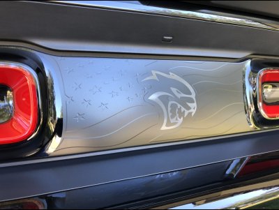

    785F5A66-6A1E-44A2-A353-8A1B94DB2F11.jpeg Saw this on another site
  8. Katshot
    That looks nice.
  9. B5blueRT
    Hey Katshot, that would look great on your Hellcat! (LOL)
  10. Katshot
    Wise guy!
