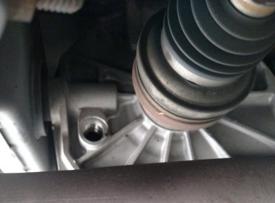

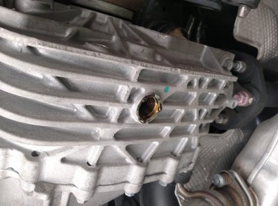

    First tip: "Don't open the drain plug until you've opened the fill plug". Good advice. I did the top one first. Mine required a 10mm allen-type wrench, I have some that fit on a 3/8 drive rachet. Worked like a charm, no problem getting either one open. Here's where they are:
    Filler Hole (on side of rear diff):
    Drain Hole (on bottom):

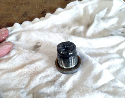

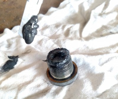

    The drain plug is magnetic. This allows it to collect any bits of metal that wear off so they don't accelerate the wear. Mine had a little bit of mung, but not bad for 70000 miles.
    Drain Plug:
    Scraped off so you can see how much is there:

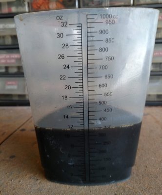

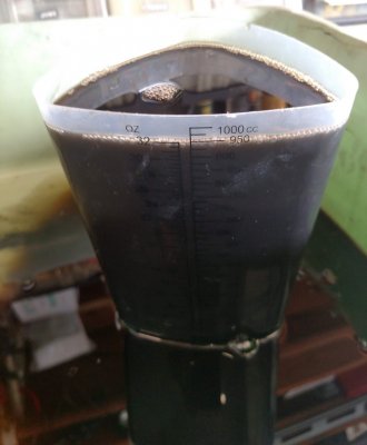

    There was some discussion of how much new oil put in. I think the consensus was that the diff holds 1.3 quarts of fluid. There's also talk of "How do you know you got it all out?" "Can you be sure you're not overfilling it?". I used the measure-what-came-out-and-put-that-much-back-in method. Near as I could tell, about 1 quart and 12 ounces came out. That's pretty close to 1.3 qts, so I there's probably not enough left in there to worry about. I used a measuring thingy in the catch pan to get most of it, let what wouldn't fit drain into the pan, then poured that in the measuring thing after emptying the first quart.

    Second 12 ozs:

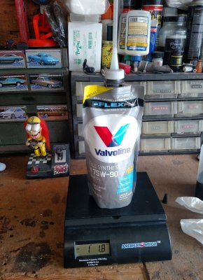

    Putting in the first quart was a no-brainer. Squeeze 'till it's empty. Doh! But, how do you measure out the other 12 ozs? I used the weight method. Mail scale. Weigh a full pack. Divide by 32. Times by 12. Subtract that number from the full number. Looks like it got pretty close. Not sure it's all that critical:
