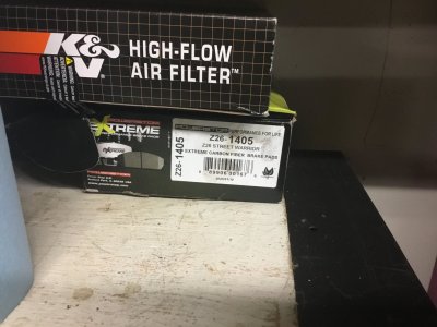

  10. 2017 Redline HC
    I went with the street warrior pads.
