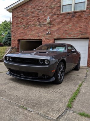

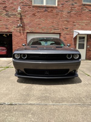

So I just didn't like the chrome grill and fuel door on my SXT Plus so I decided to replace them and figured I might as well install the larger chin spoiler. Pulled the front end off and got everything installed over the weekend. Took me three hours.
i did the same to mine, but I didn't have to pull the front end off, I was able to just remove and replace, I think only one hole didn't match up so I drilled one and solved that problem.
Well, to replace the grille you have to pull the front end. Actually it made it easier to get the chin spoiler installed. It was easier to remove the front end then to change the chin spoiler. LOL!
The car came with the Chrome Gille and Fuel Door. I replaced both with the "BlackTop" grille and fuel door. It was really easy taking the front end off. I watched a YouTube video on it. My next move is the T/A RAM Air Hood and Ram Air intake system and then some "Black Noise" Wheels. I already installed the HellCat paddle shifters because it didn't come with any paddle shifters and used the ALFAOBD software and OBDLINK MX+ to program the shifters and enable the performance pages in it.
