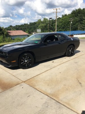

    By the way, Nice looking car, lets see more pics :)
