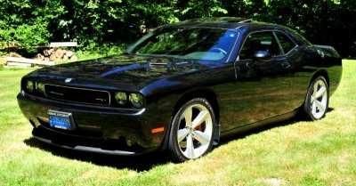

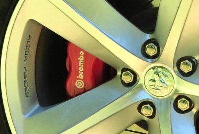

    894
    Yea, .7mm may not sound like much, but it is.
    BTW, Yes, the SRT8 Alcoa wheels look and run great. I actually found a second set for $375 for my Snow Tires.
    And I have had 295/40/20's on them with no problems, but 285/40's have less of a bulge.
    My wife want me to go to the NEW, Black Helcat wheels, and I may need to for the 315 slicks.
    But they are just not as classy.

    That is what I was seeing with the Aftermarket Hellcat Wheels too,
    The are NOT ALCOA-FORGED
