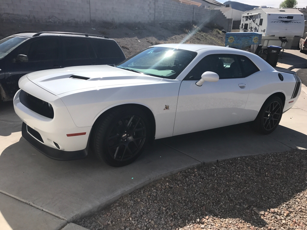

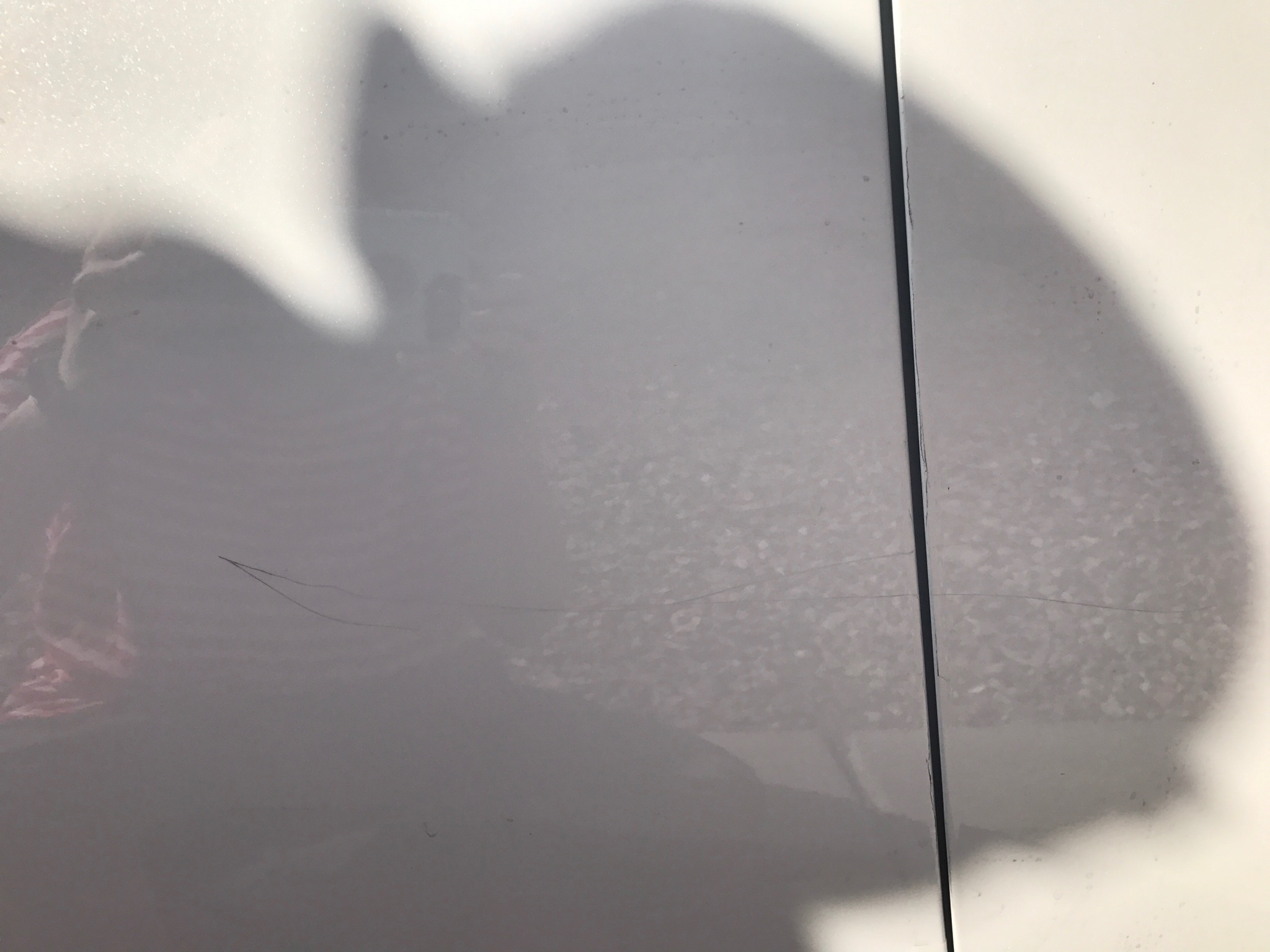

    I got a new challenger scat pack a few months back. The car has 1300 miles on it, took it out today 2nd gear feels like I'm crushing rocks. My wife drives it more than I do she babies it. Im reserved in it as well but I'm not afraid of it ether. But second is unbelievable it's a peach. It will down shift fine but 1st to 2nd no way. It started off this morning just barely nibbling the 2nd gear as it went in now I put about 40 more city miles on it and it's flat out f+^#]}=%. I've had nothing but problems with this car since I got it. The dealer lost the second key, so when I got the car I got one key. Fought with them to get the second key, they picked the car up and drove the hell out of up to the dealership. Car has GPS on it that I can track in real time. They bring the car back and modified it for me in the form of monster scratch down the passenger side. Finally it goes to the body shop this Wednesday to get half of the car repainted. There is a lot more crap with the dealership but this is the gist of it. Now what the heck do I do about this transmission? This car has been a nightmare since I got it, literally makes me sick. I won't take it back to the dealer I got it from but I have a feeling this is not going to go well considering the hell we have been through already. I'm at a loss seriously I realize it's only a car but my patients are shot. My wife got the car for me as a gift I've wanted something to play around in since I sold my drag cars and motorcycles several years ago. But this car was supposed to be fun and it's a train wreck. Any thoughts?
