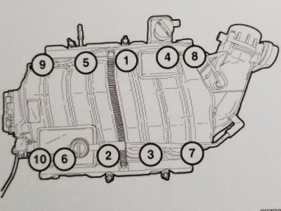

    This is a common problem that not only happens to the 5.7 but also the 6.4, the intake manifold bolts pre 2015 should be 105inch/lbs, that is INCH/POUNDS not Foot Pounds, 2015 to present is 108inch/lbs.
    Check and tighten when the engine is cold, if your 5.7 is just not performing like it was check this. The tightening sequence for the 5.7 is below.

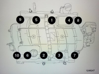

    Tightening Sequence for the 6.4 below.
    As you can see the tightening sequence is the same for the 5.7 and the 6.4. Ry

    When I had discovered mine were loose I would guesstimate they maybe had 20in.lbs. of pressure. Any looser than they were and they probably could have been turned using finger pressure. Once I discovered what the actual torque value was for mine 105in.lbs., I went to Harbor Freight and bought an Inch LB. torque wrench, cost 20 bucks. Since mine were so loose I tightened in stages something like 60, 80, 100, and then finally to 108, using the tightening sequence each time.
    Once back to the proper torque the engine cranked and ran smoother, but the first time I took it out and accelerated I was amazed at how much power returned. I guarantee if yours is seeming to have lost power and you find these bolts loose and tighten them back to spec, you will see a performance improvement.
    Do not gorilla these bolts use the proper torque wrench.

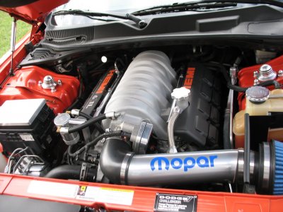

    I am glad that my 6.1 Hemi came with an aluminum intake manifold.

    The only problem with those is they get hot which is partly why Dodge stopped with the aluminum 6.1 manifold and went with the plastic on the 6.4.
  9. RyansRT
    RyansRT Active Member
    38
    28
    Jul 7, 2022
    Darlington, South Carolina
    That has always looked fantastic on the engine, and your bolts stay tight, but you do have the added heat soak of the aluminum intake, but that is a small price to pay for it's performance.
    Your under hood looks fantastic, the manifold is so clean! :)
