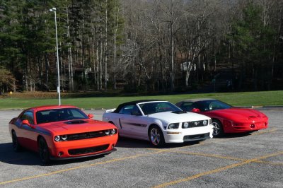

    Michelin, Goodyear, BF Goodrich 'top of the line' all season tires will keep you at the top of the game with no worries. Minimal tramlining, good even wear, and 'trust' when you are in the mood for some 'fun' driving. Yes, pricey for sure but no shortcuts with tires. I really believe this strongly. I have them on all 3 of my rides. The Goodyears came on my R/T. I have Michelins on my GT/CS and BFG's on my Trans Am. All Made in USA. :patriot: I make sure of that.
