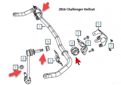

    please do!! it is MUCH appreciated! I'm guessing only 2 at most different specs,,,,one for the 2 bar bushings and another for the 4 link bolts.

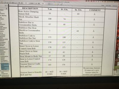

  7. 2017 Redline HC
    319
    Have a look at this, its from my 2017 manual. C6CA4031-4E4B-4750-836C-CDA9ACCAB4CE.jpeg

    So way I read it....110 -111 on the left right stabalizer bar links........but, which one is the 2 bushings on the stabalizer bar itself? is that the 136?
  9. 2017 Redline HC
    319
    Isn’t the stabilizer to crossmember the actual bushing volts?

    HEll I don;t know....I know those left / rite Stabilzer bar links hook to what I call a sway bar....#1 in the pic in original post, that "stabilizer bar" has two bushings in a clamp, in th middle-ish of the bar about 12" apart. That sounds like the Tension strut to cradle ?
