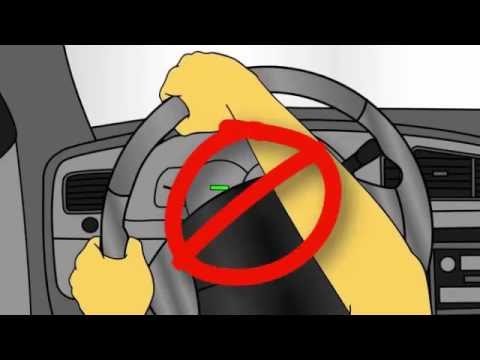

    Apply pressure to the steering wheel. The steering wheel is locked in place using a pin on one side. When locked, the wheel will not be able to move in either direction freely, but one side will not allow any movement whatsoever (the side with the locking pin). Determine which direction the wheel cannot move, then apply pressure in the other direction while turning the key with your other hand.
    · It is the process of turning the key while applying pressure to the wheel simultaneously that will unlock the steering wheel.
    · The wheel will only move slightly in the direction opposite the pin, but won't move at all in the wrong direction.
    Do not shake or rock the wheel. You may be tempted to shake the wheel back and forth while attempting to unlock it, but doing so will actually decrease your chances of successfully unlocking the wheel. Instead, apply steady pressure in one direction on the wheel until it unlocks.
