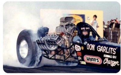

    [​IMG]Shouldn't Don Garlits be using these? No, FYI, he should not if he actually wants TRACTION.
    You can try some 20 or 15-series tires and wheels and demonstrate their superiority. NO racing teams use them. Period.

    I must comment, here, Don Garlits, THE Top Fuel Drag Racer, and the father of modern Top Fuel Dragster, did not use a bird catcher on the front of his engine scoop. He put his throttle blades in the eight injector barrels under the scoop.
    I often wondered about that, but the pocket of air over the injector barrels would form a consistent high-pressure zone with far less time, (in milliseconds) between throttle input and engine response change than would a "bird catcher" I would think
    Don proved the value of his setup, one way or another, anyway.
