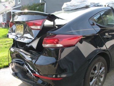

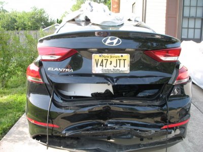

    Here are two photos of my wife's 1 year-old Hyundai Elantra that got rear ended by a distracted driver of a Jeep Cherokee. Her car was stopped, along with others, on I-295 due to a tire flying off a tractor trailer. It only had 8,000 miles on it. GEICO totaled it. Fortunately, the car did its job and she was not injured.

    Man! That's awful, but also stresses the point about so much of the car still being fine. The 'parts' side in the business world must be booming these days.

    The Key is Hard, with the structure of the rear unibody chassis , floating rear end, how the damage transfer and then with the Air Bag's destroying the Dash unlike the older cars.
