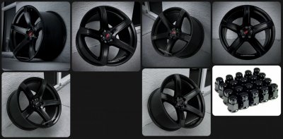

    Just want to know if anyone have issue with 20x9.5 wheels on their v6 models.
    Thinking about getting 20x9.5 HC2 wheels on all four with 275/40 tires.
    Thanks in advance.

    Thank you. Can I read this as 20x9.5 with +18 won’t work on my SXT?
