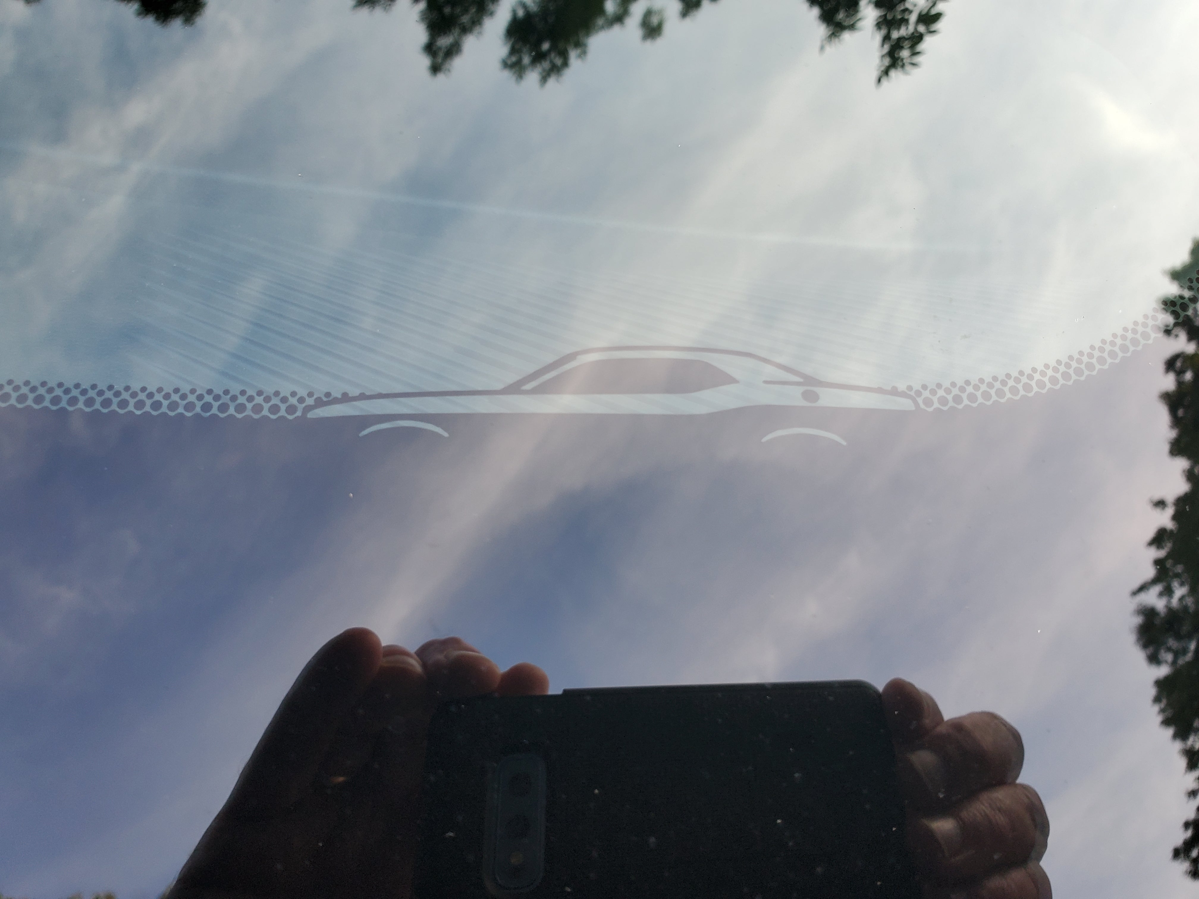

    You need to take the windshield out, strip the paint, epoxy prime the mounting area, then reset the windshield.
    Make sure that the new windshield is OEM and contains the Challenger image on the driver side lower corner.

    Thank you - My build was 10/20 per the door so I might be getting a recall. I never noticed the Challenger image on the driver side lower corner. Montana uses sand and gravel instead of salt for winter ice so we tend to replace windshields often - gonna need to make sure I always get that logo!
