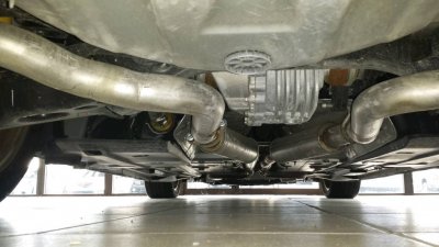

    So all the Challengers have this Getrag rear end?
  10. BBBAD345
    BBBAD345 Full Access Member
    83
    26
    Feb 2, 2020
    USA
    No.
    If it looks like the one with ribs on it it is the Getrag.
    If it looks like the one that has a smooth casting it is the less desirable Mercedes rear end.
