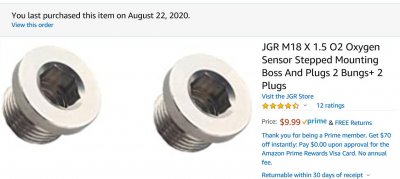

    Back to my P0430 HACK
    So before I cut up a Brand New O2 Sensor,
    I pulled the Left O2 Sensor and drove it in. to work.
    Popped an O2 HEATER Failure.
    Well Duh, it is no longer there.
    Started looking for a big ass Resistor to handle the Heater Element Current .
    Then I got to thinking,
    "This is the Down Stream, After the Cat, O2 Sensor"
    What is it looking for?
    CLEAN AIR, No Hydrocarbons
    Pulled Both O2 Sensors, Plugged the Holes
    and Tie Wrapped them to the Transmission Crossbrace.
    BINGO, Heater Error and P0430 Error GONE :)
    All for $9.99

    Figured I would TEST the fix on both rear O2's

    Well, that didn't work.
    50 miles and popped
    P2096 and P2098
    Fuel Trim System too Lean
    So I just pulled the O2 sensors and taped the ends.
