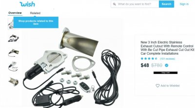

    So since the add now says sold out I assume you made the purchase? Good savings....o_O

    2 things,
    1) On cheap cutouts, the mechanism tends to stop working due to heat damage.
    2) Get a good cutout set with a remote so you don't need to drill up into the cabin.

    I would wonder how many people who have these on their cars even know when they're malfunctioning. As long as one side even opens a little, the car will make a good deal more noise. My guess is a decent amount of these are out there on cars and they are only partially working.
