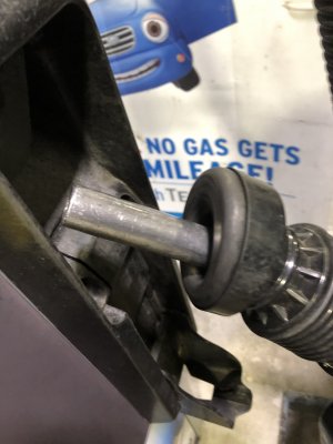

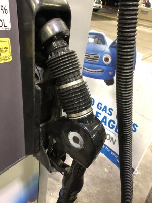

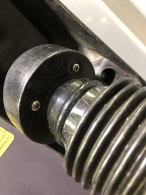

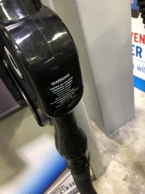

    Also going to take a pic of pump nozzle. It looks a little different from the pumps I’ve been using (no vapor seal?)

    Pumped gas at 3rd Chevron again (WED 1/15). Put nozzle in all the way, right-side up. Pumped manually full speed. Filled to full with no stoppage (14gal). No problems at all at this station. Here is what the pump looks like, maybe there’s no vapor shut off?

    That's a full vapor recovery nozzle. The vapor recovery system isn't what shuts off the fuel though. There's a small orifice tube at the end of the nozzle. That's what shuts fuel flow. Bottom line, when fuel is exiting the nozzle faster than it can get into the tank, it backs up in the filler neck, blocking off the orifice tube and shutting off the pump handle. There can be multiple variables affecting this:
