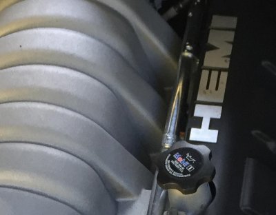

    Still confused about the question
    as the Filler Cap has:
    "Use Mobile-1 0-40wt" printed right on it?
    IntimidatorRT likes this.

    That's correct. Dodge switched from Mobil1 to Pennzoil somewhere around 2012 ... I think 2013 might have been the first full model year for Pennzoil. (I guess the memory really is the first thing to go.)
    Some say the switch to Pennzoil was merely a marketing move based on money.
    Some say the switch to Pennzoil was due to engineers looking for an oil that provides better protection at idle.

    Mobil 1 is an excellent oil and I have used it my 2009 SRT since day one. It is specified for high performance European cars that run at prolonged high speeds.
    Years ago, Chrysler cut a better deal with Pennzoil to use their oil over Mobil 1. This is why they now recommend Pennzoil. Mobil 1 decided not to undergo extensive testing of its oil to meet Chrysler's new specifications.
