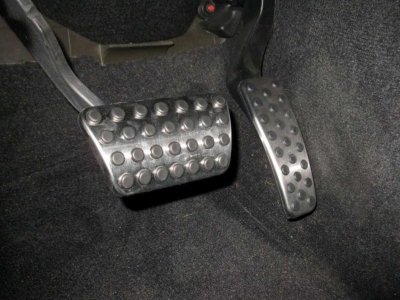

    LOL OK bro but don't say the old medic did not warn yah.
    hint...soak in super hot water, have a short flat head screw driver, and a ton of
    lubricant for the brake swap

    Yup. Did it last Sunday. The brake went on in about a minute. I heated it up in an ice cream bucket when I poured boiling water over it. Let it soak for about 5 to 10 minutes. It went on real easy. Draped it over the top and the two slits on the side let me pull back the rubber and wrap it around the brake pedal. I heard it pop in on the lower right and then I took a stubby screw driver and helped the lower left in. No cussing. No sore fingers. One minute and I was done. The hot water must have been the trick.

    looks great...
  8. Storm Rider
    Looks great and thanks for the tip on using hot water to make them pliable.
