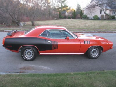

    Can't agree more. The 340 was known as the "giant killer" at the track and the NHRA factored its horsepower up to 325. Here is my old 1971 'Cuda 340.
